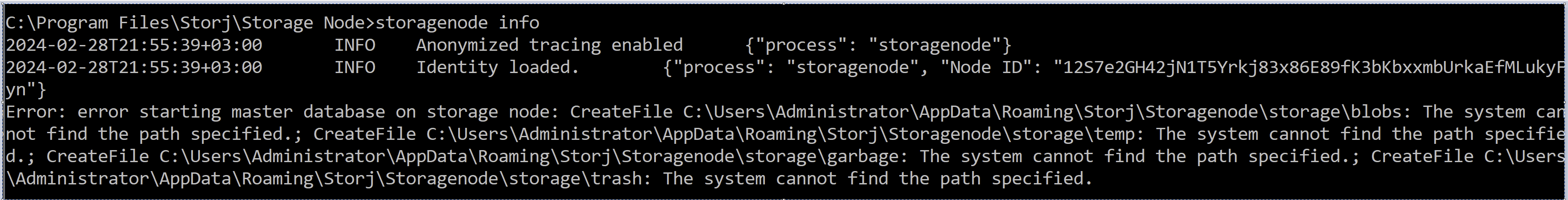

I manually downloaded the file and tried to run it
Apparently the new version did not read the paths from the settings file config.yaml ?
Do you need additional keys to execute the command?
storagenode help - runs fine
No, that’s sufficient for that test. I wanted to make the first check for whether there’s any init time, DLL related or anti-virus related issues – in which case the binary wouldn’t start at all.
