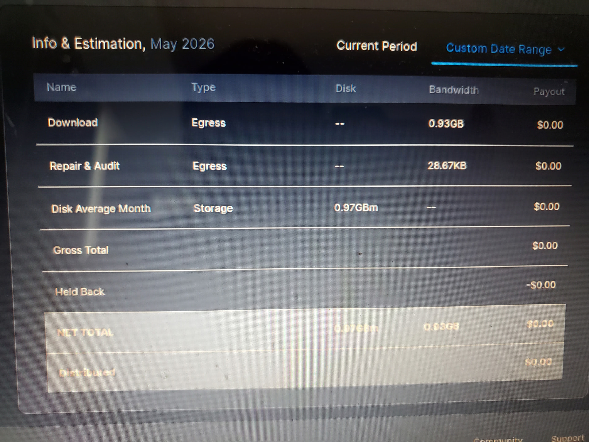

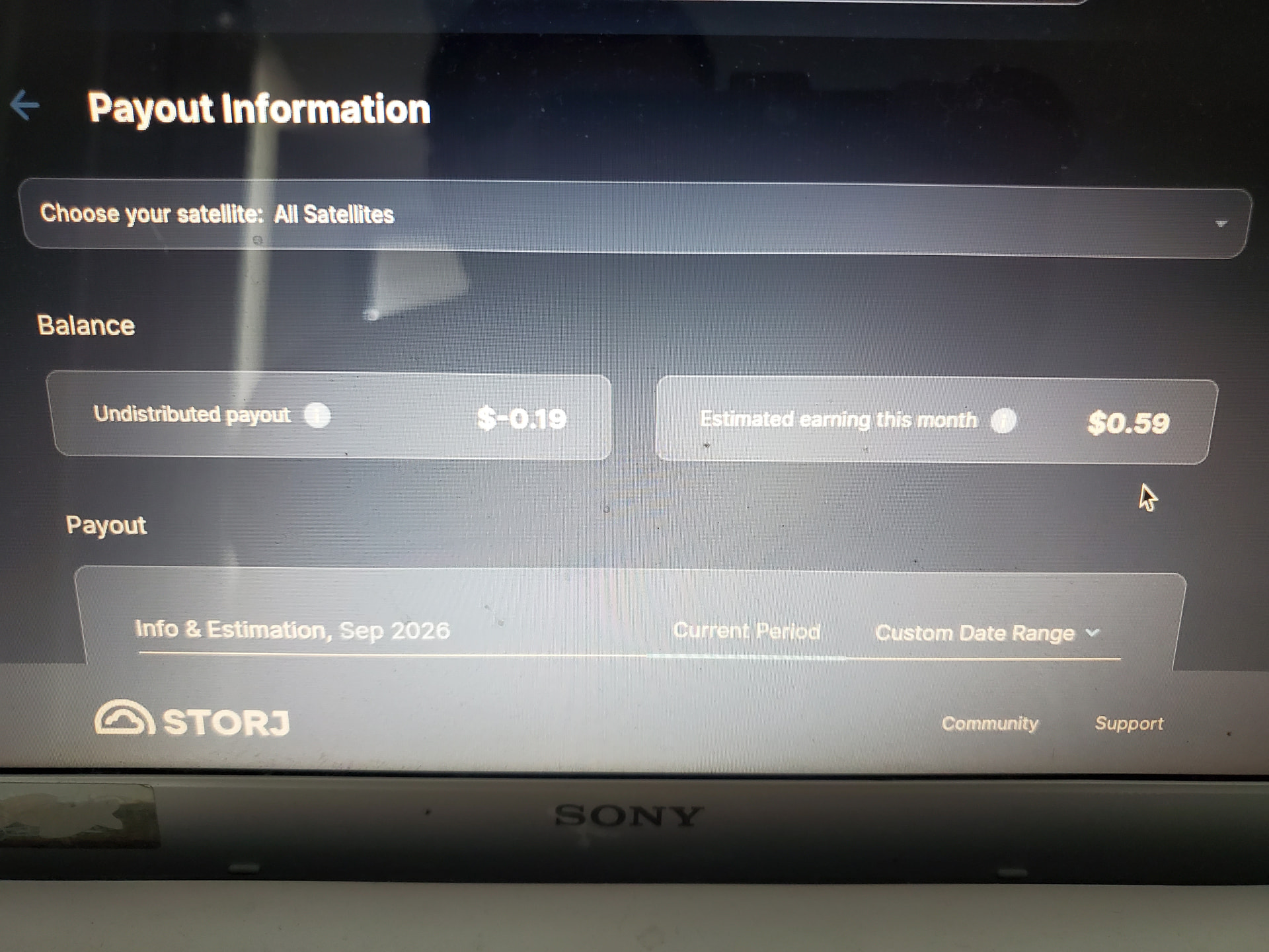

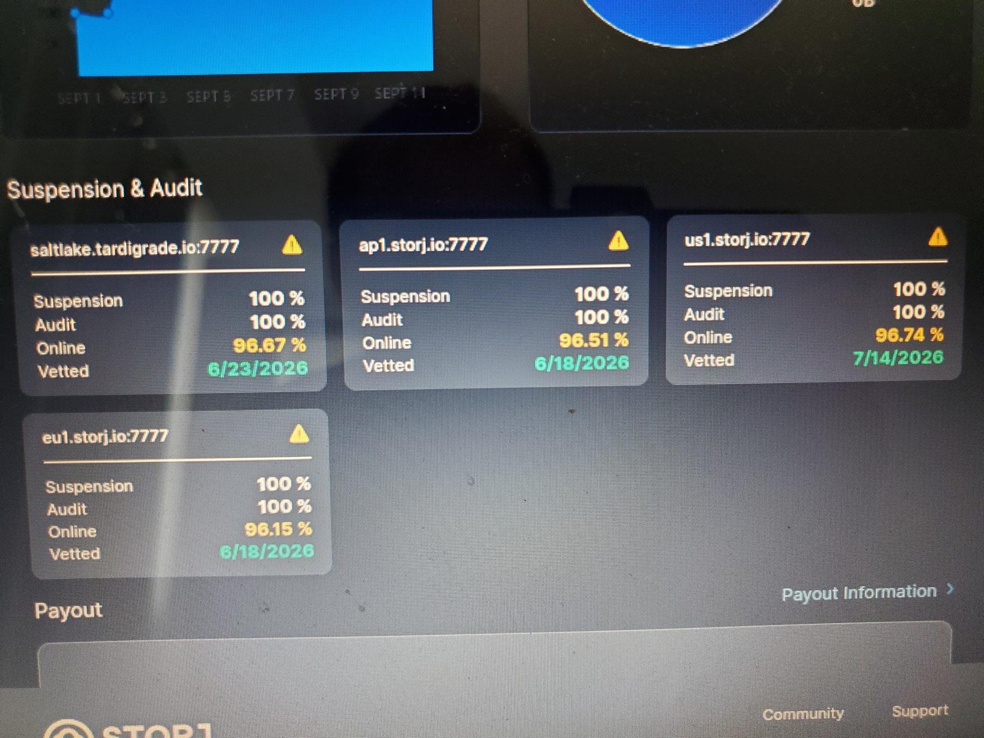

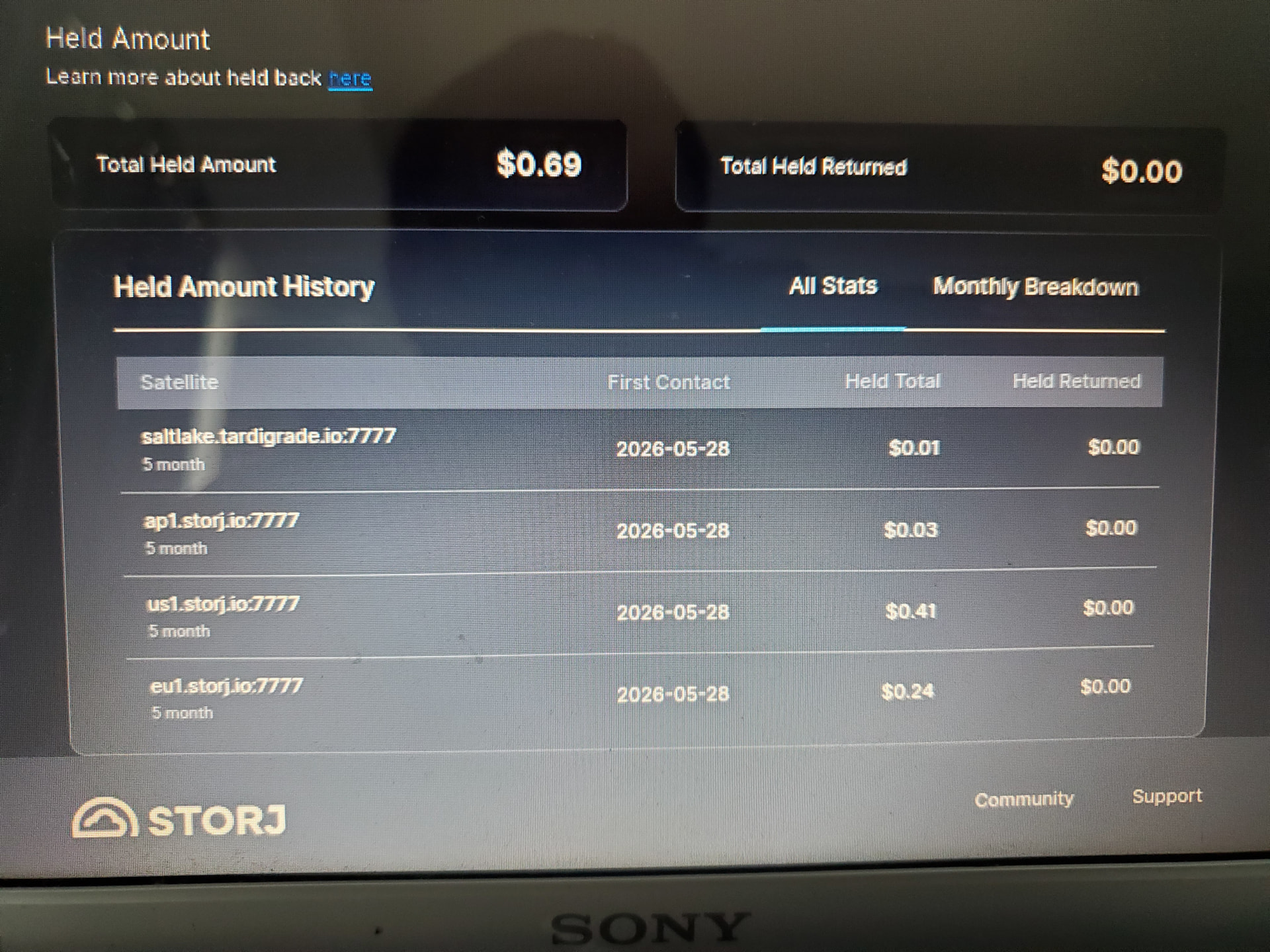

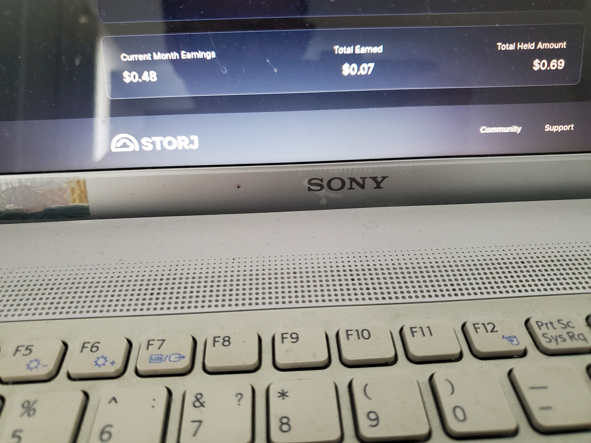

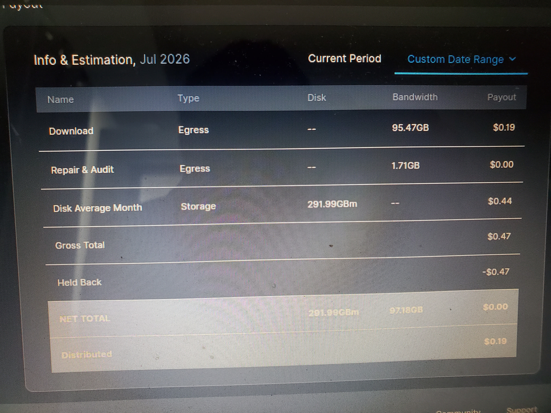

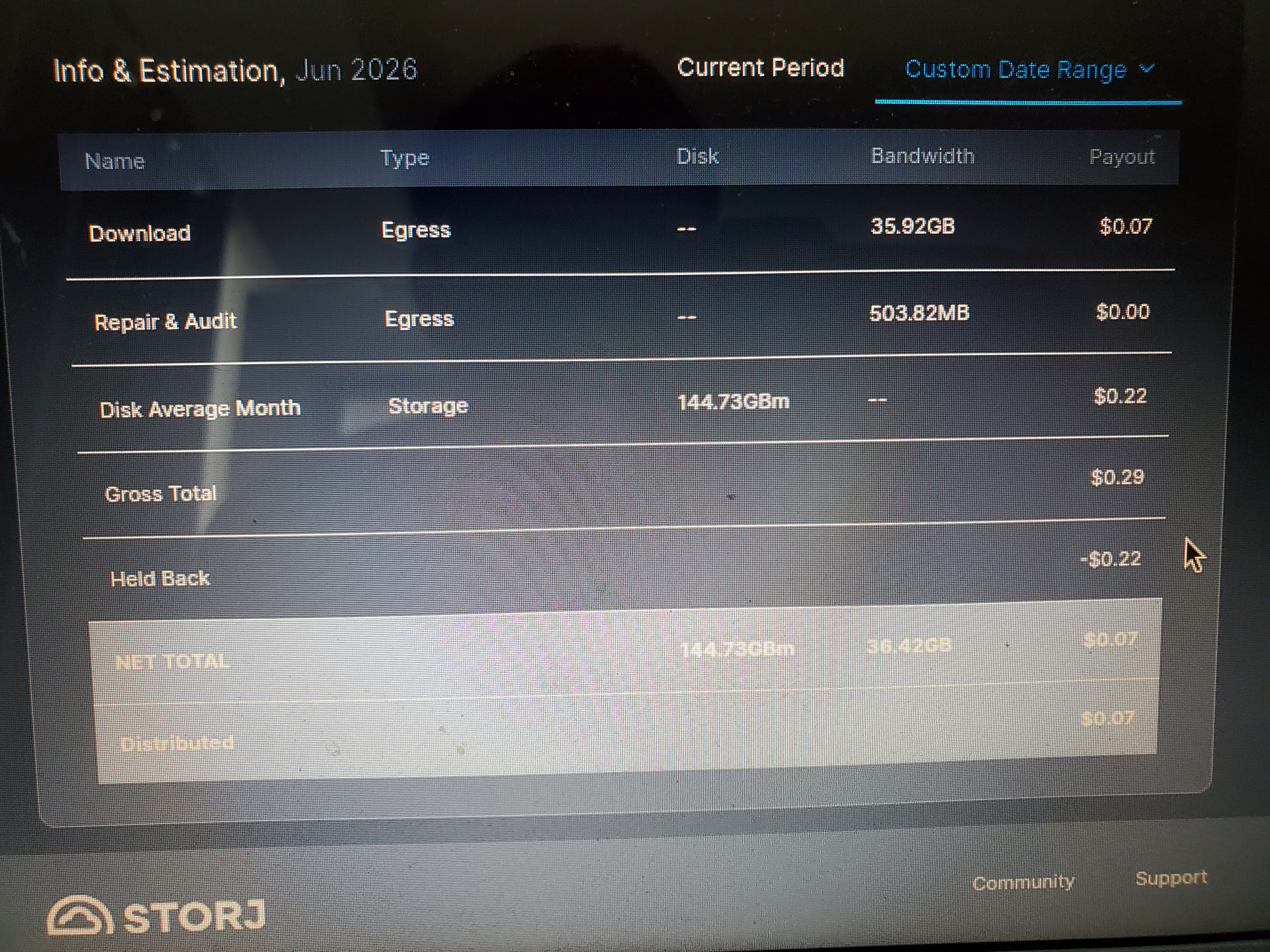

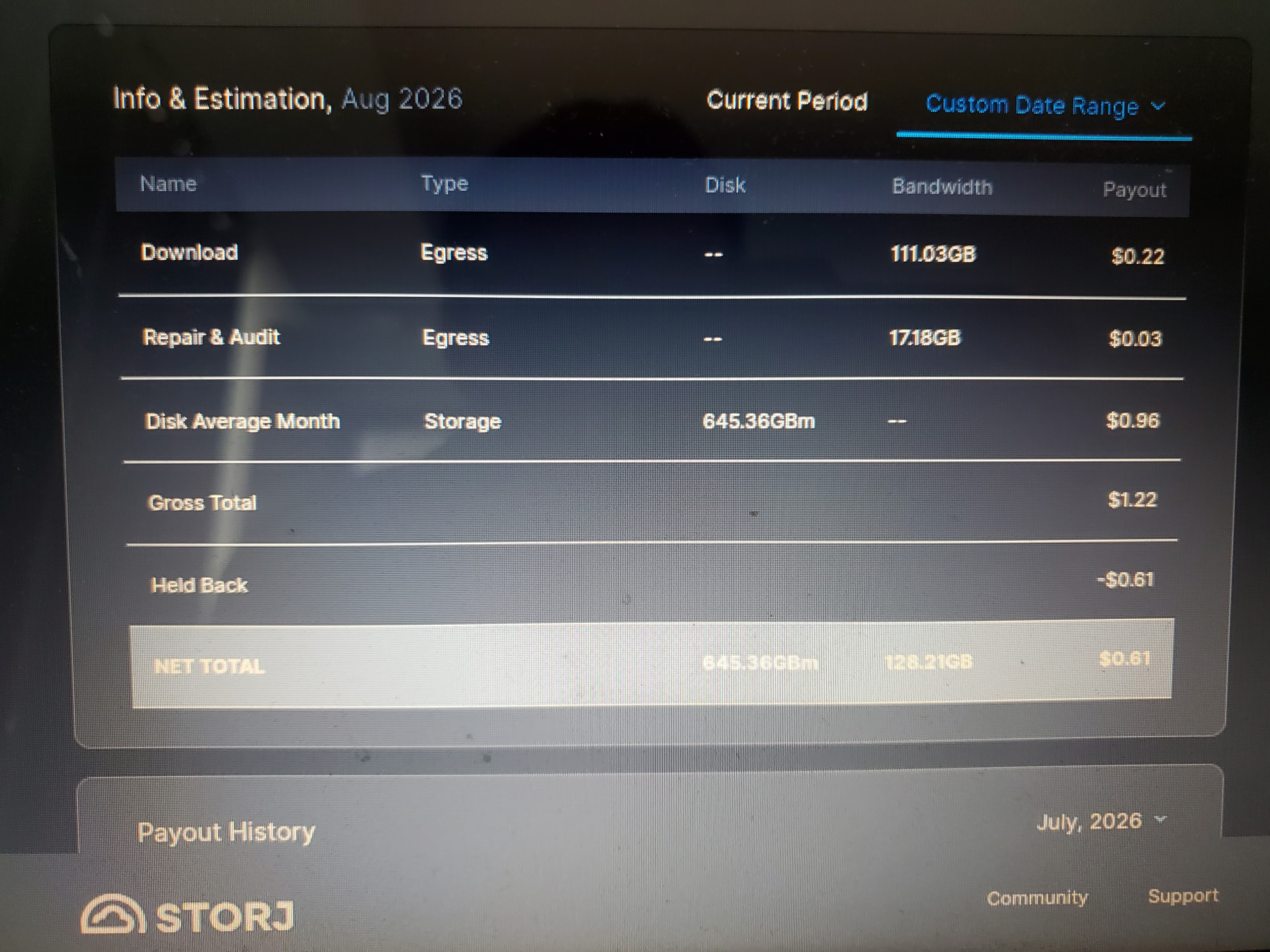

I need advice! Please help! My “Total Earned” has been staying unchanged for several months while “Total Help Amount” has been increasing. I am getting the impression that storj is rip off or scam. While my node would go offline for short while genereally it always online and running smoothly, in the 96-99% range availability. I run from May 2026 until now. Something if not right o_O

Screenshot would help. Also a lot of data in the dashboard is wrong because node does not babe all the data. Satellite knows correct numbers.

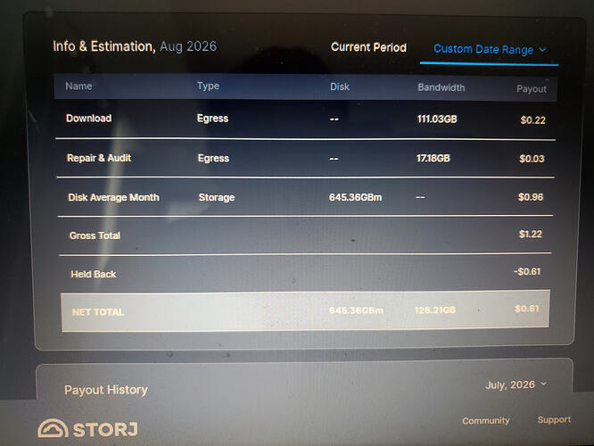

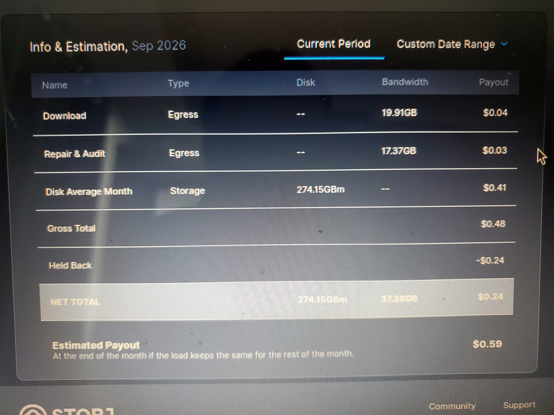

It looks like up to July you may have not earned enough to reach the minimum-payout (especially because of holdback). Then the August prepayment was accidentally low and based on July numbers… so still too low. But now between your real-August numbers, and the Sept estimated prepayment based on it… you should have enough banked for a payout.
Except the payouts started… and stopped around 20%-done two days ago. You can’t win :slight_smile:
I think you will get some STORJ this time… if they can get past the technical problems.
First, if you are going to demand professional standards from Storj, take an actual screenshot. Photographing a dirty monitor with a phone is sloppy and lazy.

You started in May, and until the end of June the node was still being vetted. So you have had roughly two months of normal operation on a brand-new node, and it has earned the whole twenty cents or so we are arguing about here. This is not evidence of some long-running scheme where Storj took your investment and refused to pay you.
And again, the node dashboard is not authoritative accounting. The node knows what happened locally. It does not know which competing transfers ultimately won or lost until the satellite does the accounting and reports the result.
I am not sure if we are on the same page or what? For the last 2 months, I have been earning over a dollar a month, considering that Storj withholding a % due to the node is new, yet Total Earned shouldn’t be 7 cents at this time. The point I am trying to make is that I am looking at the trend of where it’s all going and asking myself why I should commit hardware resources to a business that does not appreciate it? And when you say Storj doesn’t beg me to run the node, here is where I have personal question for you. Do you work for storj? If yes, then I certainly wouldn’t want to do business with such partners. If not, then why would you speak for them? In any case, if Storj is absolutely careless about whether someone helps them earn money or not, than certainhly it not where you want to waste your time and hardware resources.
Like I said, if you work for storj I find your replies unprofessional, trying to shift your focus wether my screen is dirty or clean. It’s about whether the information you see is relevant or not to understand. If you volanteering and just willing to help, well than help. If you’re in a bad mood, come another time.
No, I don’t work for Storj. You posted on a public forum asking for help. I replied to you despite having to decipher numbers from photographs of a smudged monitor instead of actual screenshots. Calling that “unprofessional” is a bit rich.

You may refresh the total earned and total held by restarting the node, it reads these values only on start. @arrogantrabbit is correct on many aspects:
  • we suggest to use only what you have now which will be online with Storj or without, only in that case any earnings will be a pure profit, because you already paying your invoices for that online hardware, so any return is a nice discount to your bills;
  • the statistic on the dashboard is estimated based on Avg Disk Used this month, but this metric is provided by satellites not regularly and sometimes not full, because it might take more than a day to calculate it and this process can fail. However, this metric is not used to calculate a payout, it’s used only to estimate usage accounted on the satellite and estimate a future payout on your dashboard.
  • the correct numbers are calculated from orders, which node sends to the satellites after successful upload or download, these orders are used to calculate a real payout in the end of each month. Before payout is completed you can see only estimations made by the node, and usually they should be close to what is going to be paid, but if it has missing data, the estimation will be wrong. When the payout is completed, satellites sends receipts to nodes and you can see them in the Payout History with real numbers and TX link, if your node was able to clear a minimum payout threshold. If the node was unable to clear it - the unpaid amount will be increased instead.
  • Starting September 1, 2026 the payout rates are reduced (see Rightsizing Storj Network Payout Rates), but I believe that the node is still use old rates to calculate estimations. I hope it will be fixed in a new release.
The negative unpaid amount is a result of prepayments, see
and
