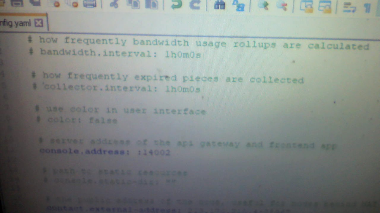

i change console address but still cant login

i enable console address but still cant get access with second pc, try also console ip and port,1207.0.0.1:14002 nothing
WIN_20201005_19_43_32_Pro
Your configuration looks good. Are you still able to access the dashboard on the machine that is running the node? Is the node machine and your main laptop on the same LAN? You made sure to save the config.yaml file before restarting the node, yes?
im using wifi on both devices. yes on console i can still open web dashboard but on my laptop not working, yes first i stop node, change config,restart node,start node
