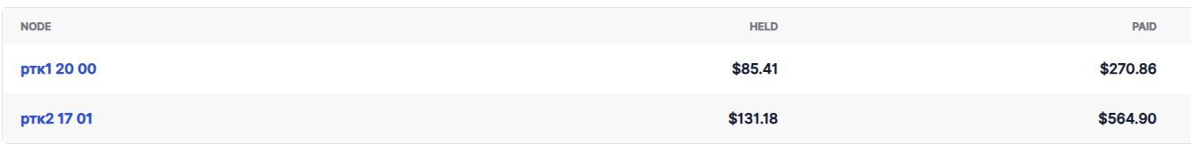

just installed new version of dashboard and:
i wish it will be correct but sadly in real life node is showing this amount:
and
all the databases are ok
do we have a solution or suggestion how to fix this funny bug?
It shows the earning for the whole node’s life. You need to select a period.

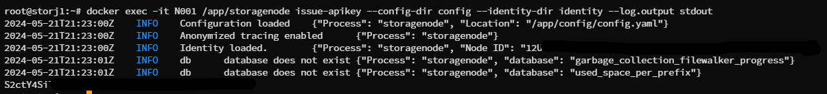

sudo docker exec -it N001 /app/storagenode issue-apikey --config-dir config --identity-dir identity --log.output stdout
I got this

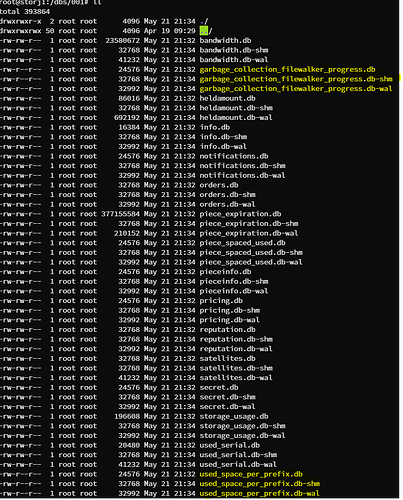

I see that dbs at the folder where I store, not in the hdd, they are stored in an ssd.
Is there something I’m doing wrong or is it something I’m not seeing?

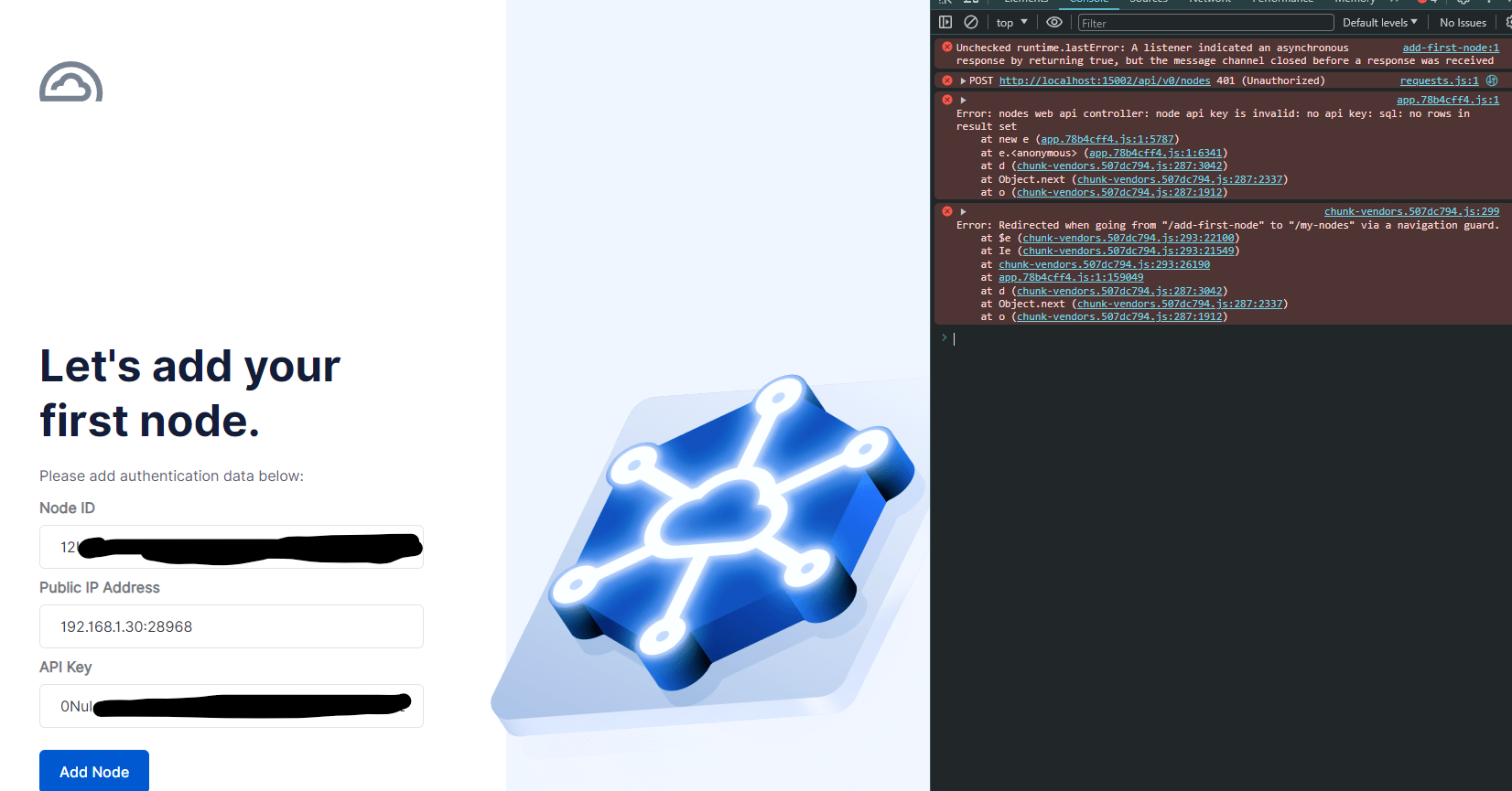

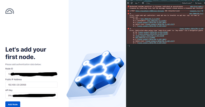

Yes, the multinode dashboard launch correctly but when I try to add the first node I got the error posted before
Same thing on windows and docker
It says that the node’s API key is invalid. Perhaps because it is… invalid?
Please generate it using the command
Please replace everything in <...> to your actual values to get a correct API key, also please note - you need to use your node’s external IP and port, not to the dashboard, but the regular port like 28967/tcp.
