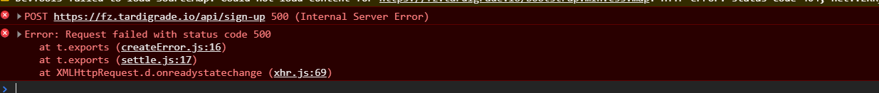

I tried to sign up for the test but the request API seems to be down.
Hello @Plemonade,
Welcome to the forum!
It runs out of accounts. It should be fixed already.

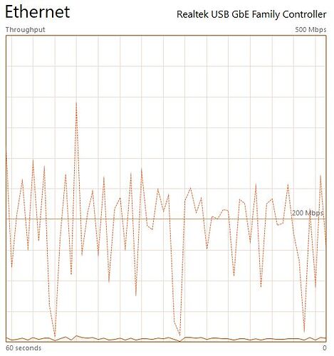

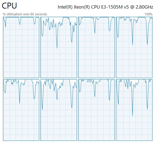

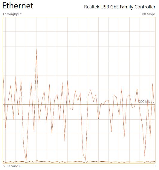

As others have stated the upload kills my machine. CPU is maxed on 4 cores, 8 threads. I’m on a 500/500 leased line but my upload is bouncing all over the place.
cpu
With any low powered cpus you will see high cpu useage because of the encryption process before it uploads.
