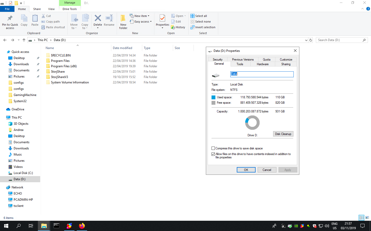

I now have another issue: yesterday I have noticed that the dashboard shows the HDD as filled up. If I check the HDD properties though, just 200 GB are used. In the configuration of Storj I have given about 800GB as total amount to be used, so I should still have about 600GB which are free to be used.
Thank you.
The screenshot or copy of dashboard would be nice
I will provide it to you as soon as I have access to the computer again. I do not have configured my computer to be accessible remotely (at least that I am aware of… :-D)
Dear @Alexey, please find some print screens here below:

I have a one suspicion. Have you migrated from the Docker to the Windows GUI recently?
If so, please, give me a result of this command (Powershell):
sls path "$env:ProgramFiles/Storj/Storage Node/config.yaml"
Perhaps you have not specified the storage folder with your old docker data, instead you specified the folder one level higher and now you have a two blob folders there, one in the specified path, and second in the storage subfolder.

Please, give me result of this command:
ls D:\StorjShareV3
Dear @Alexey,

Dear @Alexey,
please find results below:
PS C:\Windows\system32> ls D:\StorjShareV3
    Directory: D:\StorjShareV3
Mode                LastWriteTime         Length Name
d-----       10/19/2019   3:51 PM                blobs
d-----       10/19/2019   3:17 PM                garbage
d-----       11/15/2019  10:26 PM                storage
d-----       10/19/2019   3:52 PM                temp
-a----       10/19/2019   3:52 PM         225280 bandwidth.db
-a----       10/19/2019   7:32 AM            752 config.yaml
-a----       10/19/2019   8:36 AM           8192 info.db
-a----       10/19/2019   8:13 AM          24576 kademlia
-a----       10/19/2019   8:13 AM         262144 kademlia.bak
-a----       10/19/2019   3:52 PM         790528 orders.db
-a----       10/19/2019   8:36 AM          16384 pieceinfo.db
-a----       10/19/2019   8:36 AM          20480 piece_expiration.db
-a----       10/19/2019   3:52 PM          12288 piece_spaced_used.db
-a----       10/19/2019   3:52 PM          12288 reputation.db
-a----       10/19/2019   8:13 AM              0 revocations.db
-a----       10/19/2019   8:46 AM          32768 satellites.db
-a----       10/19/2019   3:52 PM          32768 storage_usage.db
-a----       10/19/2019   8:13 AM           4774 successrate.sh
-a----       10/19/2019   3:52 PM         323584 used_serial.db
If I look at the content of the blobs folder, this is what I see:
PS D:\StorjShareV3\storage> ls D:\StorjShareV3\blobs\
    Directory: D:\StorjShareV3\blobs
d-----       10/19/2019   3:52 PM                abforhuxbzyd35blusvrifvdwmfx4hmocsva4vmpp3rgqaaaaa
                                                 aa
I know that while doing the reinstall with the Windows installer I made confusion with the folder tree. This is why I am posting also the content of the folder D:\StorjshareV3\storage:
    Directory: D:\StorjShareV3\storage
d-----       10/19/2019   8:13 AM                blob
d-----       10/19/2019   7:51 AM                blobs
d-----       10/23/2019   8:07 PM                garbage
d-----       10/23/2019  10:09 PM                temp
d-----       10/19/2019   8:13 AM                trash
-a----       11/15/2019  10:22 PM        2207744 bandwidth.db
-a----       11/15/2019  10:23 PM          32768 bandwidth.db-shm
-a----       11/17/2019   6:23 AM        1083592 bandwidth.db-wal
-a----       10/19/2019   3:53 PM           8192 info.db
-a----       11/15/2019  10:23 PM          32768 info.db-shm
-a----       11/15/2019  10:23 PM              0 info.db-wal
-a----       11/15/2019  10:22 PM       34369536 orders.db
-a----       11/15/2019  10:23 PM          32768 orders.db-shm
-a----       11/17/2019   6:23 AM         770472 orders.db-wal
-a----       10/19/2019   3:52 PM      212635648 pieceinfo.db
-a----       11/15/2019  10:23 PM          32768 pieceinfo.db-shm
-a----       11/15/2019  10:23 PM              0 pieceinfo.db-wal
-a----       10/19/2019   8:13 AM           4096 piecestore.db
-a----       10/19/2019   8:13 AM          32768 piecestore.db-shm
-a----       10/19/2019   8:13 AM          78312 piecestore.db-wal
-a----       10/28/2019   3:09 PM          20480 piece_expiration.db
-a----       11/15/2019  10:23 PM          32768 piece_expiration.db-shm
-a----       11/15/2019  10:23 PM              0 piece_expiration.db-wal
-a----       10/28/2019   3:09 PM          12288 piece_spaced_used.db
-a----       11/15/2019  10:23 PM          32768 piece_spaced_used.db-shm
-a----       11/15/2019  10:23 PM              0 piece_spaced_used.db-wal
-a----       11/15/2019  10:22 PM          12288 reputation.db
-a----       11/15/2019  10:26 PM          32768 reputation.db-shm
-a----       11/17/2019   2:25 AM         263712 reputation.db-wal
-a----       10/19/2019  11:09 PM          32768 satellites.db
-a----       11/15/2019  10:23 PM          32768 satellites.db-shm
-a----       11/15/2019  10:23 PM              0 satellites.db-wal
-a----       11/15/2019  10:22 PM          69632 storage_usage.db
-a----       11/15/2019  10:26 PM          32768 storage_usage.db-shm
-a----       11/16/2019  10:23 PM         230752 storage_usage.db-wal
-a----       11/17/2019  11:23 PM        4382720 used_serial.db
-a----       11/15/2019  10:23 PM          32768 used_serial.db-shm
-a----       11/17/2019  11:46 PM        4136512 used_serial.db-wal
And if I look at the content of the D:\StorjShareV3\storage\blobs folder, here what I see:
PS D:\StorjShareV3\storage> ls D:\StorjShareV3\storage\blobs\
    Directory: D:\StorjShareV3\storage\blobs
d-----       10/20/2019  11:50 AM                abforhuxbzyd35blusvrifvdwmfx4hmocsva4vmpp3rgqaaaaa
                                                 aa
d-----       10/23/2019   2:05 AM                qstuylguhrn2ozjv4h2c6xpxykd622gtgurhql2k7k75wqaaaa
                                                 aa
d-----       10/20/2019  12:58 AM                ukfu6bhbboxilvt7jrwlqk7y2tapb5d2r2tsmj2sjxvw5qaaaa
                                                 aa
d-----       10/23/2019   8:14 PM                v4weeab67sbgvnbwd5z7tweqsqqun7qox2agpbxy44mqqaaaaa
                                                 aa
The folder D:\StorjShareV3\storage\blob is empty instead.
Thanks a lot!
I see. You have some missed data in the root folder. Please, move it to the right place: open Powershell or cmd and execute:
robocopy /MOVE /S D:\StorjShareV3\blobs D:\StorjShareV3\storage\blobs
Your usage stat would be still wrong, but at least you will have all pieces in place
