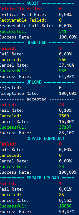

These rates are good
I don’t think so. you have a very high cancel rate.
How is your node and the hard drive connected?
sata and wd blue 1 TB 5400 rpm
almost all download of saltlake is being canceled :neutral_face:

Then there is no need to worry. Look again at the success rates in a few weeks or when the node has more data.
Ingress is very low today, my 14TB nodes got 250 megabytes today.
Means that your node has lost the race for the piece. Normal process.
