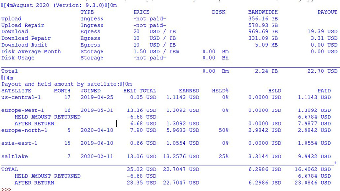

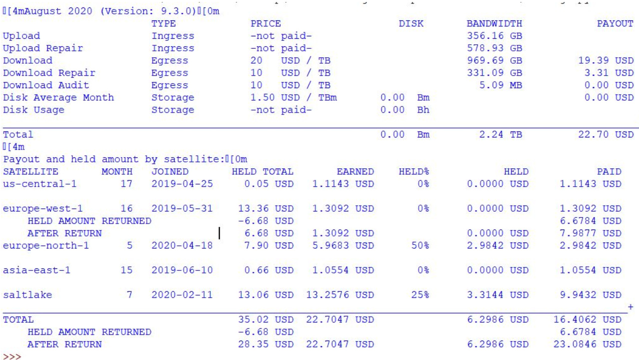

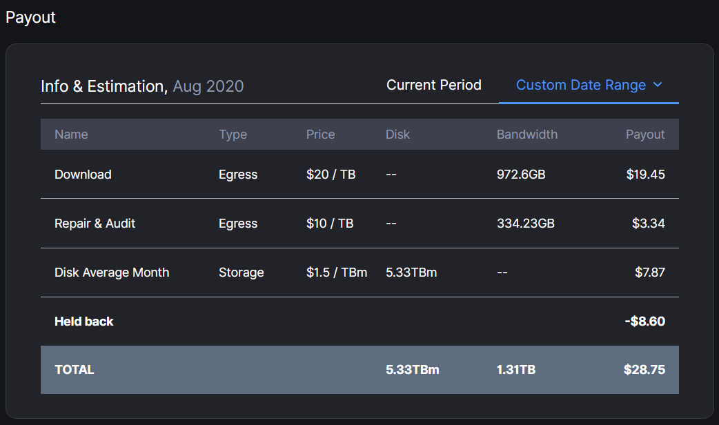

EDIT: Actually the PAID column of $16.4 is incorrect and much lower than what dashboard had for August period of $35~
EDIT2:
Total $37.35.
-8.60 held for August
$28.75
However the script shows Payout $22.70 and under satellite’s paid $16.4062…
Also the returned held amount of $6.68 is not even shown on dashboard, OR paid.
@BrightSilence, is the script ver 9.3.0 not working as intended with node 1.11?
EDIT3:
Replaced all .db files again.
The script is working just fine with that version. It needs to be updated for 1.12 though, which I will get to when I get that version.
But the output you get should be correct. What numbers are different from the web dashboard?

I’ve edited the above post and included the August payout from the dashboard.
Total $37.35.
$28.75

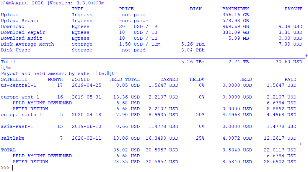

It looks like the earnings script is unable to find your disk usage data. Are you running the script directly on the live database files? (Don’t do this if you’re using docker on windows or macos. This is only safe on widnows GUI or linux docker installs.)
If you’re using a copy of the db files, please stop the node prior to copying the db files. If that doesn’t resolve the problem, check your db files for errors. Specifically the storage_usage.db.
It’s a copy of the files from the docker node which was stopped before copy commenced. Doing the script directly on another PC. Did this before and didn’t have any issues. I’ll try again.
