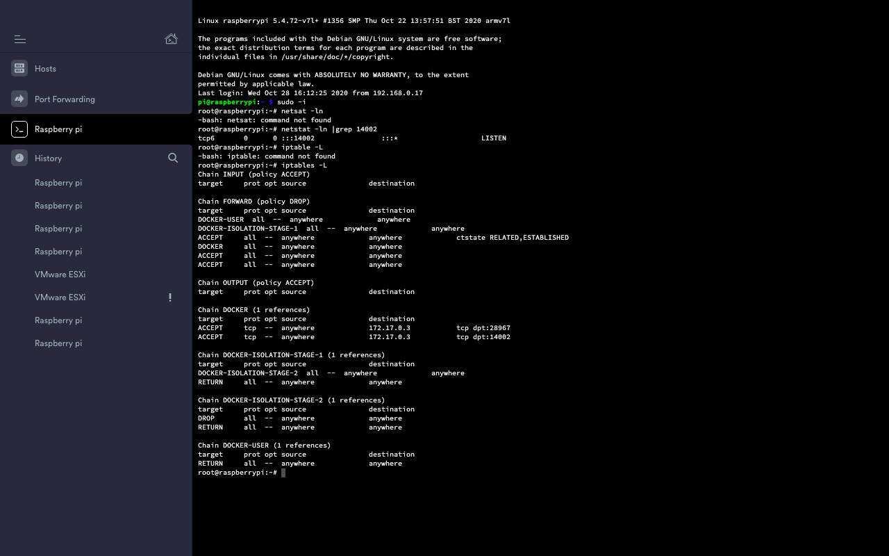

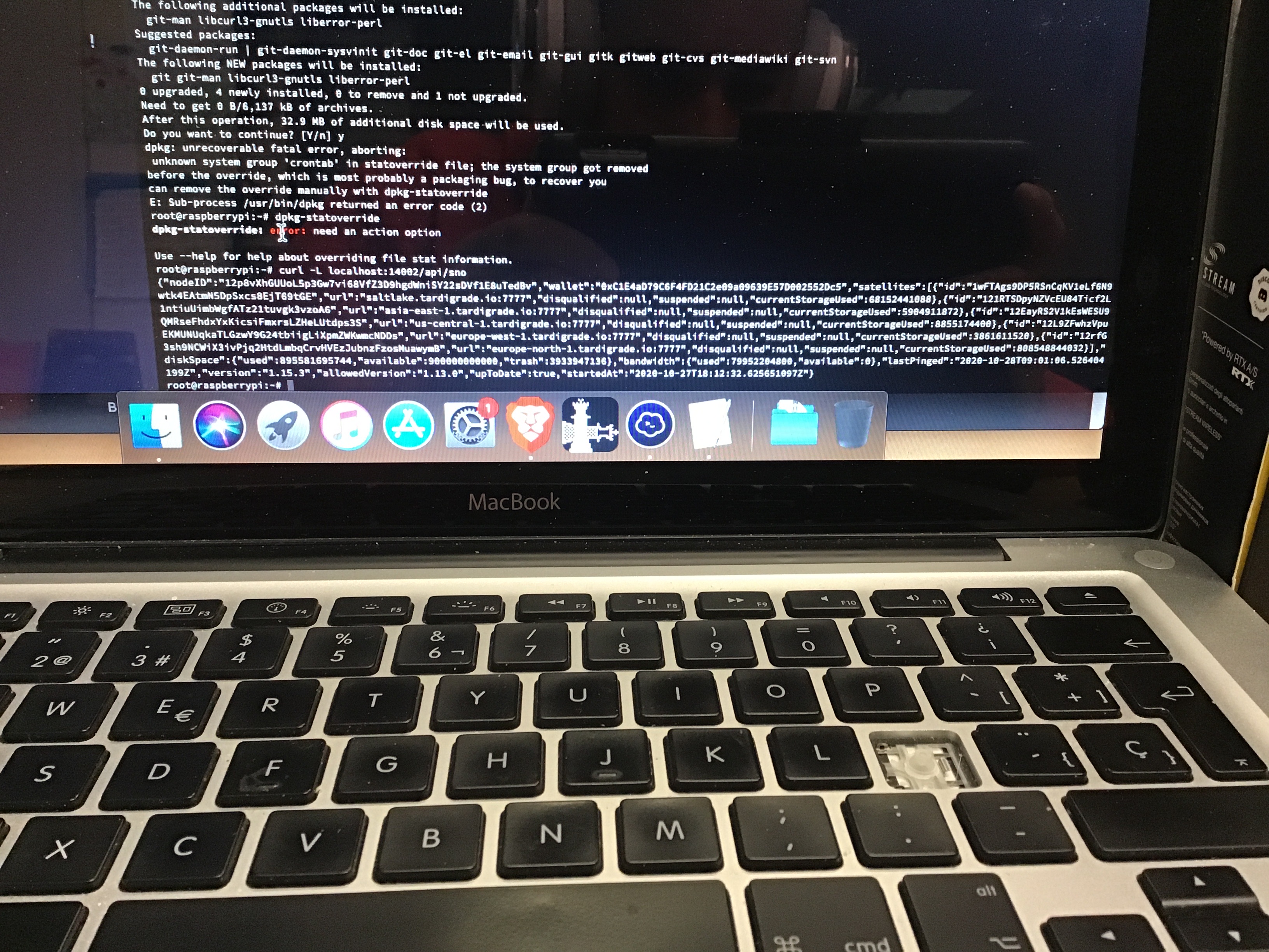

Please, try this command:
curl -L localhost:14002/api/sno
On the Raspberry Pi:
- Become root with a shell:
sudo -s
- Ensure the docker image is running:
docker ps
- Check to make sure the port is open for listening:
netstat -ln |grep 14002
- Check iptables rules for correct docker rule set:
iptables -L
Everything looks good from the Raspberry Pi side…

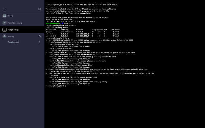

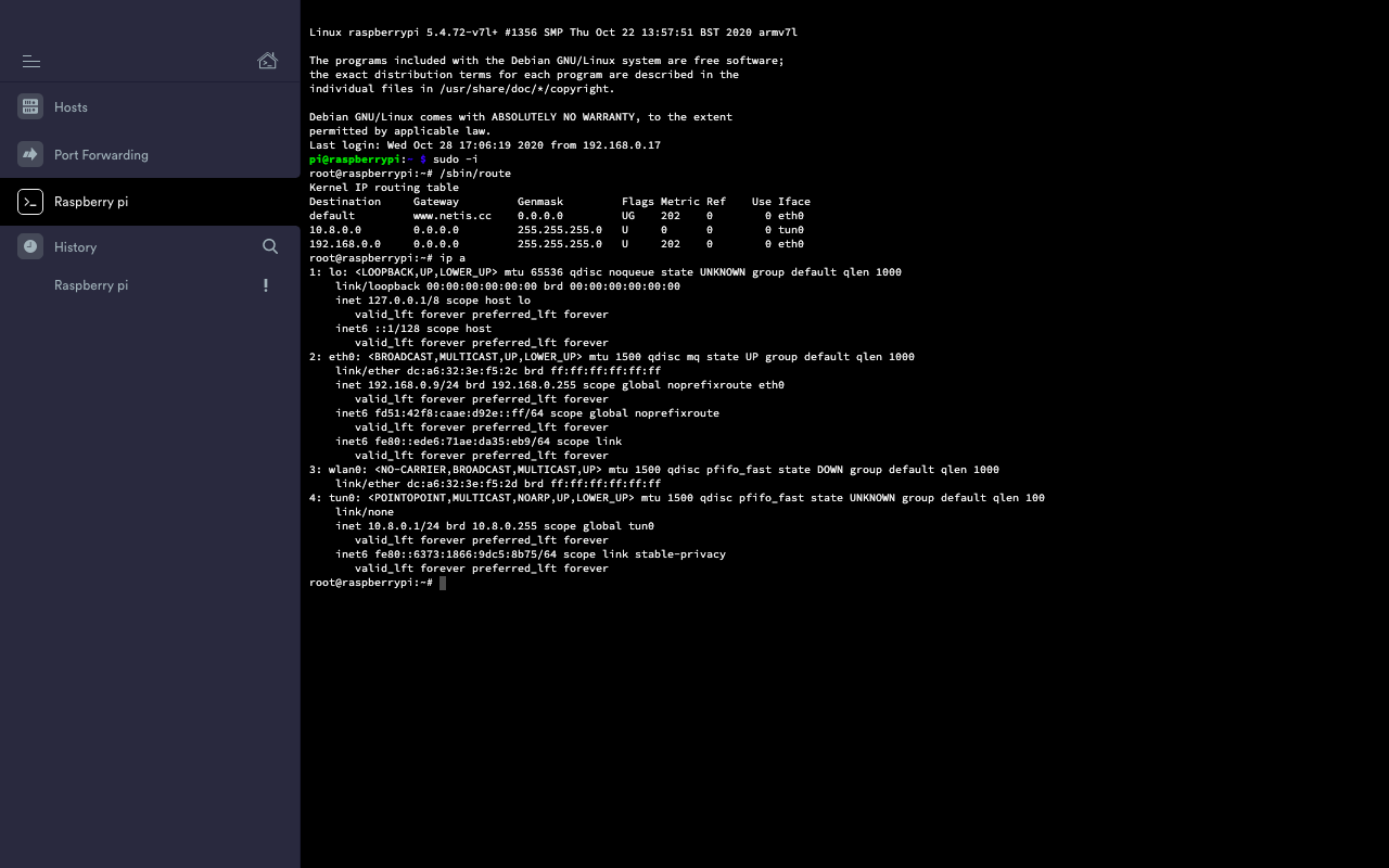

- Sanity check the IP address of the Pi:
ip a
- And check routes for good measure:
/sbin/route
And make sure it’s the same as what you’re putting in your browser… and make sure you are connecting across the same LAN subnet rather than WAN or a different LAN subnet.
If all that checks out… then there’s got to be some router and/or host configuration issue on the connecting client.

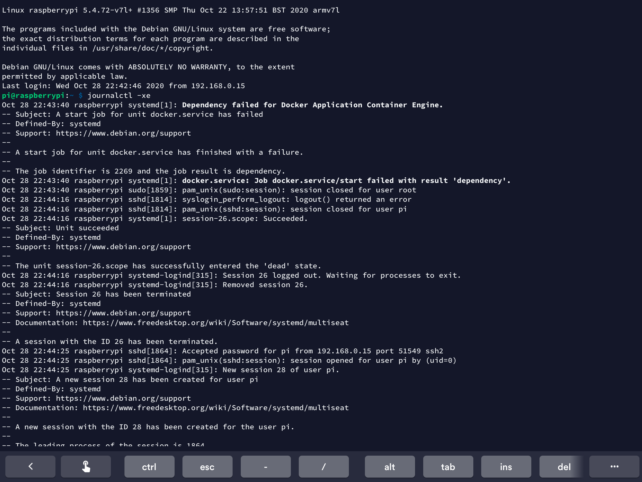

look what it says when i try to open the terminal dashboard
sudo docker exec -it storagenode /app/dashboard.sh
Cannot connect to the Docker daemon at unix:///var/run/docker.sock. Is the docker daemon running?

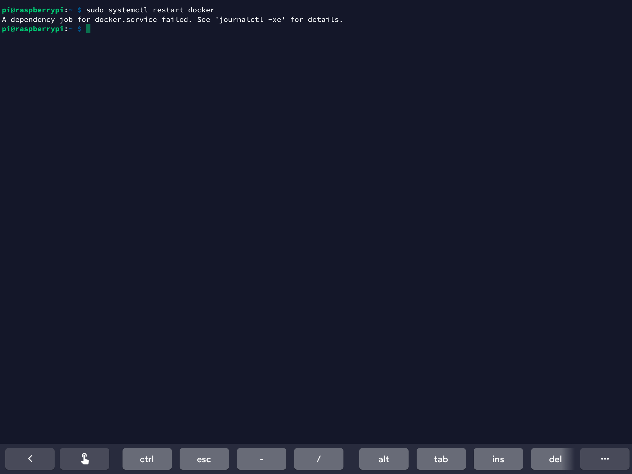

Please, try to do:
sudo systemctl restart docker
