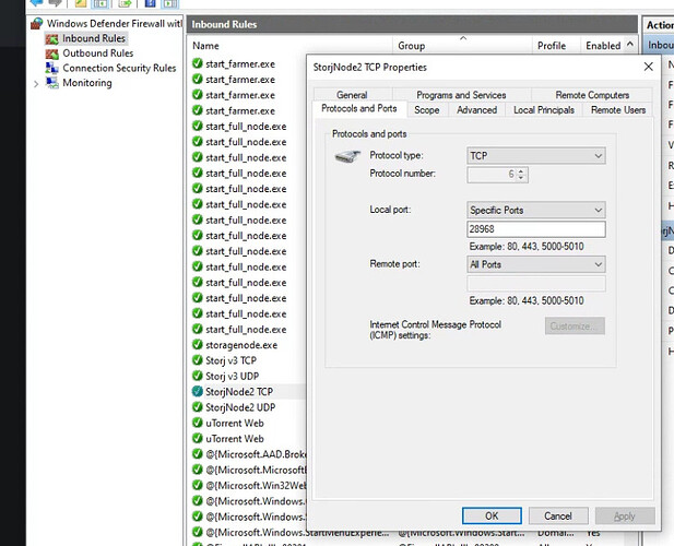

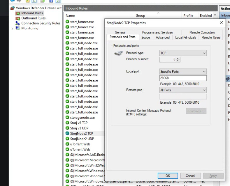

I Added TCP/UDP Inbound Rules in Windows Defender
It is enough?

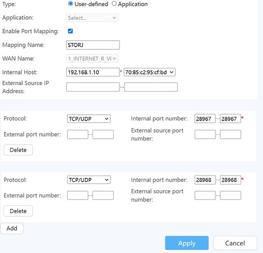

on router? port forward to this pc with this port?

I can show my router’s port forwarding on the picture.
Node 1 works, node 2 does not.

Maybe if you could give me a guide, how can I check that port 28968 is also opened?
Or delete Node 2 and try again?
Open Port Check Tool - Test Port Forwarding on Your Router (yougetsignal.com)
if this will show that port is opened, check you identity, did you signed second identity after generation with storj token?
mean that you specified a wrong path for the identity or data. It also possible, that you provided a wrong port for the second node. It should be a different one from the default TCP+UDP 28967.
You also need to update the server.address option in the config.yaml with the new port. And probably all others: How to add an additional drive? - Storj Docs

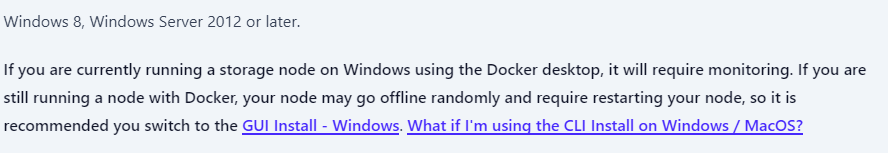

In the official Storj docs, it says that a second node can only be started via CLI, but then it also says ā€œyour node may require extra monitoringā€.
So, my question is:
By using your software, are we somehow sidestepping the use of Docker and, therefore, removing this issue?
Thanks again!

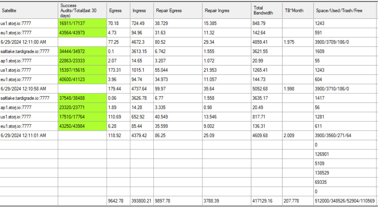

I updated my Audit App I was shocked how much trash I have.
Almost 53Tb of trash
Oh my God, almost 18% :scream: :nerd_face:
