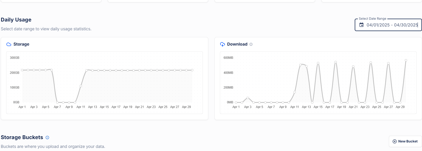

The usage on the dashboard is a snapshot of the usage on the moment when you refreshed it, and it’s in GB/TB measure units, it’s not cumulative, like GB*h.
In the invoice you have been billed for GB*h. So @arrogantrabbit is correct, some time you have used more than now. You may easily check that - on the dashboard you may select the last month and on the storage usage graph you may see when you stored more than at the end of the month.

Thanks for answer. I checked the last month. And it says only 220 GB. Below the picture.
Oh this numbers are diffrent. What does this mean ?
