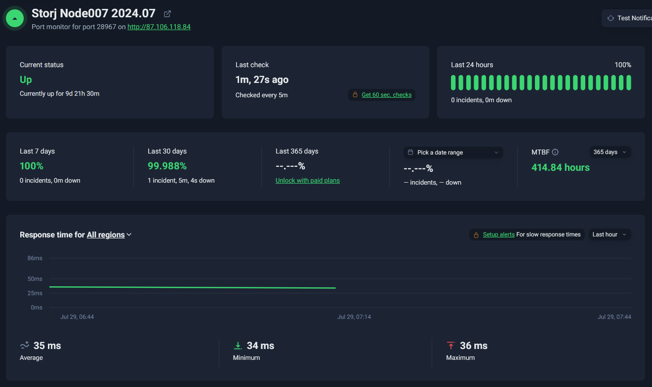

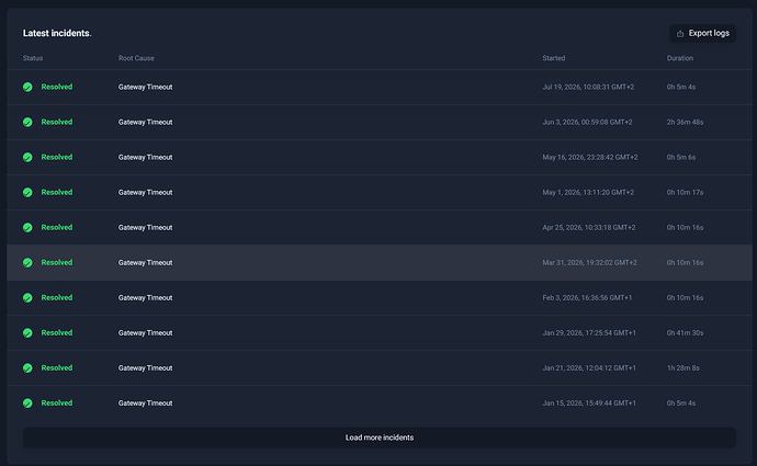

Now I can open this address, and if you still have the “ping satellite failed” with that address, then it can be added to the first group. Do you have an Uptimerobot or similar external monitoring to check the same on the same time?
for example on
Because it may help developers to take a look on a specific service.
Online check on check-in is performed by a different service than online checkers, so it will be helpful to distinguish them.
Please also provide failure windows around these dates from the audits history using these scripts:
@akester thank you for providing more evidences, that the online check on check-in might be affected too.
Please provide the failure windows around the same dates from the audit history with the script above.
It will fail due to a load balancer configuration, it drops ICMP, so you can exclude this from the equation. You need to check dRPC or at least https/http (so it will use a TCP protocol).
@surfercool I already explained the same - there are two checkers - the online check on check-in (where you receive a “ping satellite failed”) and the online checkers - a separate service, based on audits, but they only check that the node answered or not (the response is processed by the audit checkers, so if the node responded with a known error, the audit score will be affected, if it didn’t respond at all - the online score will be affected, if it’s responded with an unknown error - the suspension score will be affected).
Before that moment I didn’t have an evidence, which provided by @akester and @CubeFan , that the error “ping satellite failed” also comes for the address and port, which can be opened externally. In your similar report the address and port didn’t respond, thus I cannot prove that this online check on check-in is affected too.
Unfortunately your AI agent is wrong - it’s affecting the online score.
And thank you for the provided analyze, it has been shared with the team.
This is related to the fact that ping-back on check-in is performed by the satellite, but audit checks might come from another IP(s), since it’s a separate distributed service.
@surfercool 's AI agent is explained the same.
I provided all feedbacks from this thread.

Ok, thank you. This confirms that the online checkers have an issue to contact nodes, and when there is a true offline event (when IP is rotated), it affects the online score even more.
I think that the reason concluded by your AI agent can be the root cause.
I wasn’t aware of this issue, I don’t monitor my nodes or the forum like I used too, and I missed this thread. It seems that I too have this problem. I don’t use DDNS services, I pay for static IP, my 2 ISPs are reliable, my getway routers are mine, not ISP’s, nothing changed on my side. So Storj’s sats may be the culprit.
I don’t have time to investigate or the budget for AI, but what baffles me reading through this, is why do you use caches when the checks are suppose to check the current situation, not some cached passed state?
Here is the output of the script for node1:

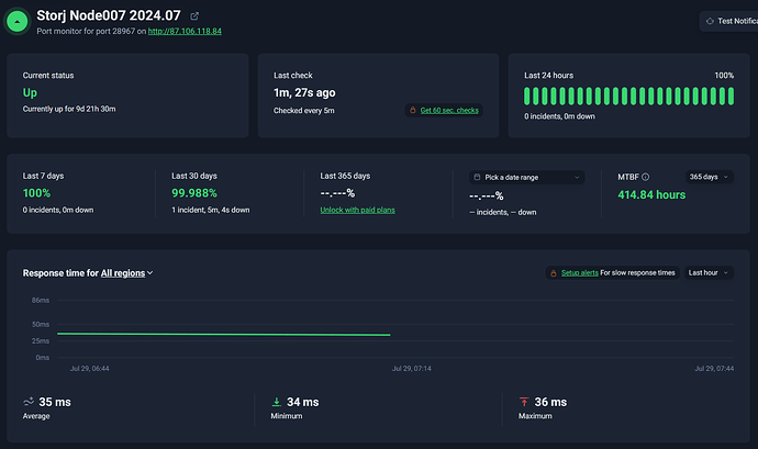

external monitoring Node7
Thanks all to help collect enough statistic. All shared with the team.
It supposed to use not a cached state, but cached IPs, like we use it for the node selection. This cache is updated on every check-in. It might be a problem for nodes which changes IP more often than once a hour, but it’s a self corrected state, even if the node is lucky enough to update its IP right after the check-in. Earlier that cache I believe also updated on audits, which might happen much more often than once a hour. But now, if these audits now doesn’t update the cache, it may try connecting the previous IP and rendered as offline until the next check-in.
However, here you showed, that the node might have a static IP, but still rendered as offline, even if it’s actually online. This makes me think, that the analyze above is correct, and the code even didn’t try to actually connect the node due to an internal timeout.
For me it sounds like a bug. Will wait for the team’s response.
We all expierience this since a week or 2 ago. There is already a thread regarding the situation. It seems there is a bug on the satellite side.
No problem, thank you for taking the time to reply.
My bet is a network issue, not a bug on satellite side. As satellites are running on different providers, the routes are different. There is a very active investigation with the hosting provider about routes to specific ASNs, but it also depends on upstream support.
We will reset all online scores which were declined due to false positive checks.
But do have a solution soon? Is it safe now to do some maintenance and short downtimes? I’m scared of downtimes because when they rerun the online-score won’t increase.
