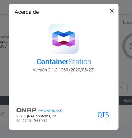

Which version of Container Station do you have? I suspect that with the latest version, it presents these problems
 Mine is: V2.1.3.1360 (2020/05/27)

I was able to download a previous version of container station and it was so
 latest version which is in the firmware of Qnap (2.1.3.1360) does not work with STORJ_1.0.2.qpkg.

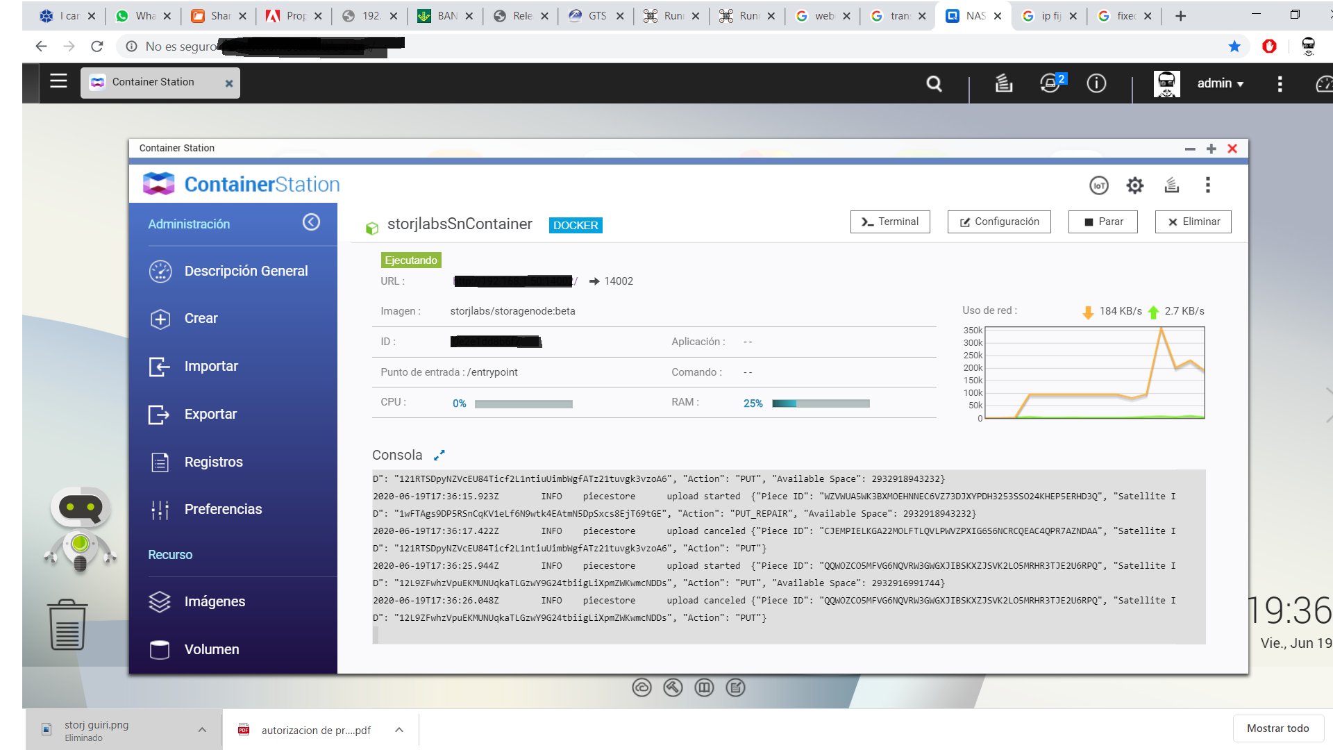

I managed to download the previous version but I have another problem
In docker from container station i have this error:
./storagenode: line 1: syntax error: unexpected word (expecting “)”)
and in STORJ_1.0.2.qpkg app i have :
LATEST LOG :
eccb2cda0316 storjlabs/storagenode:beta "/entrypoint" 1 second ago Up Less than a second 0.0.0.0:14002->14002/tcp, 0.0.0.0:28967->28967/tcp storjlabsSnContainer

But now as in the previous message, loading a previous version of the container station I solved the first part but it still gives me problems I think with assigning the ip from the container station to the docker
 with the errors seen:
LATEST LOG :

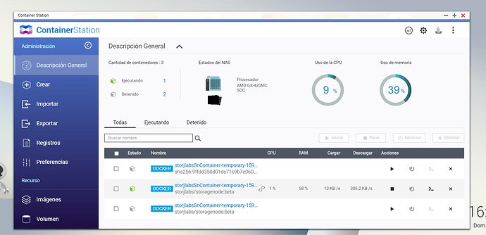

Three versions of StorjLabs have been installed in Docker. this has occurred during some system restarts. sometimes one works, other times
The node page is equally active, but I wonder if it influences audits or speed.
