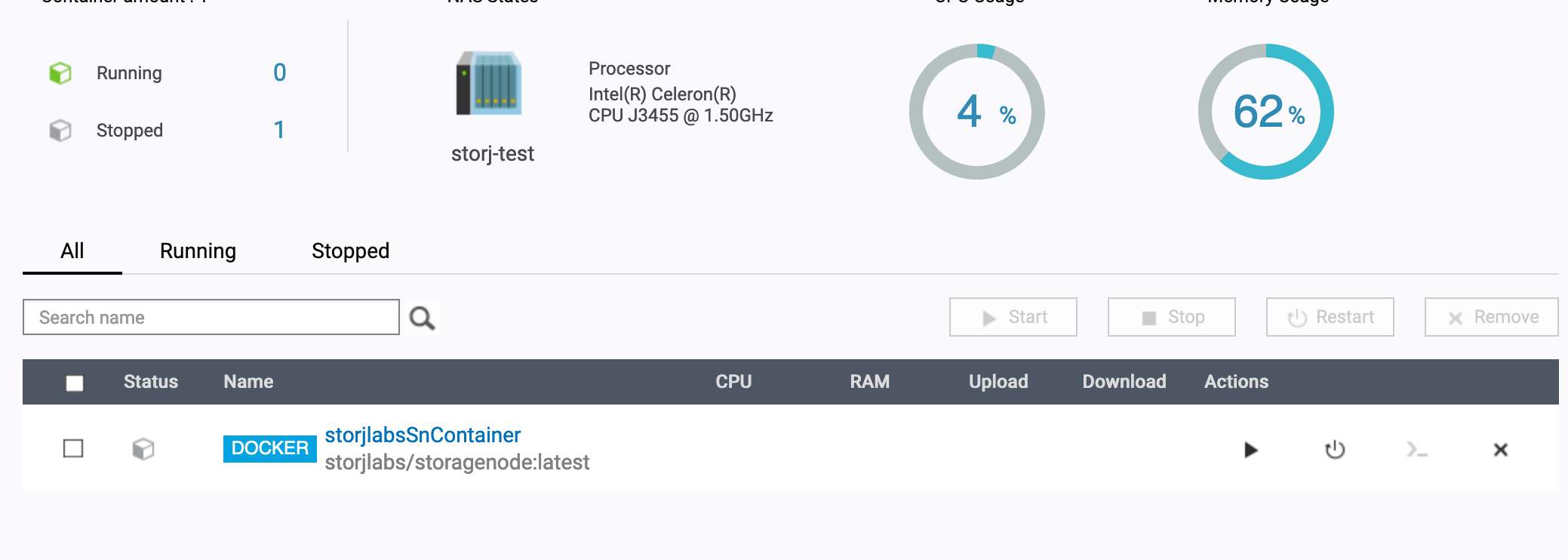

I cannot run the Qnap app with the Storj node. They can help?
Looks like it may generate new container names every time. You’d have to pass it the name of the container currently in use.
It shouldn’t.
From the screenshot @Pauantich posted it looks like an older version of the app due to the use of the beta container tag.
