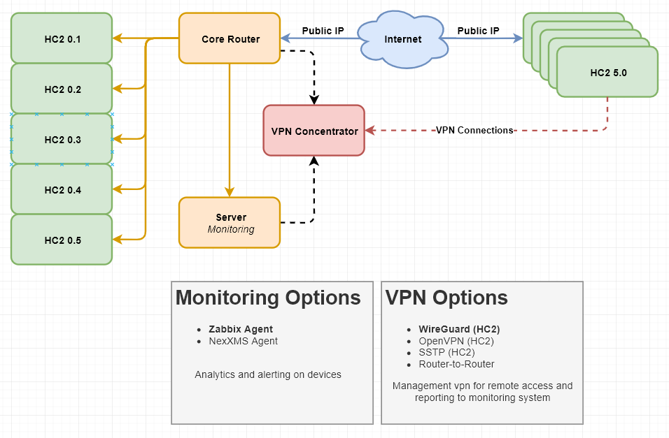

Diagram
The monitoring system and equipment is etched in pencil. Seen grafana + influxDB + prometheus monitoring on the forums. I’m all ears on other options to accomplish the same goal. Even if there is a cheaper or more solid solutions than the Odriod-HC2. Granted these have an output of 25w.

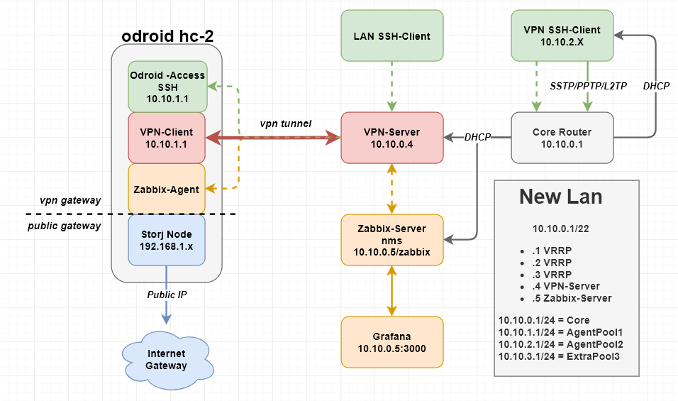

New diagram with greater detail, everything else is working as it should besides the vpn tunnel.
Currently trying a solutions @Pentium100 using openvpn.
Hope it will run soon :slight_smile:
That is not necessarily the cause of your problem. You can usually setup the routing in a way that sends everything to your default gateway EXCEPT for traffic that is targetted to your remote VPN network
