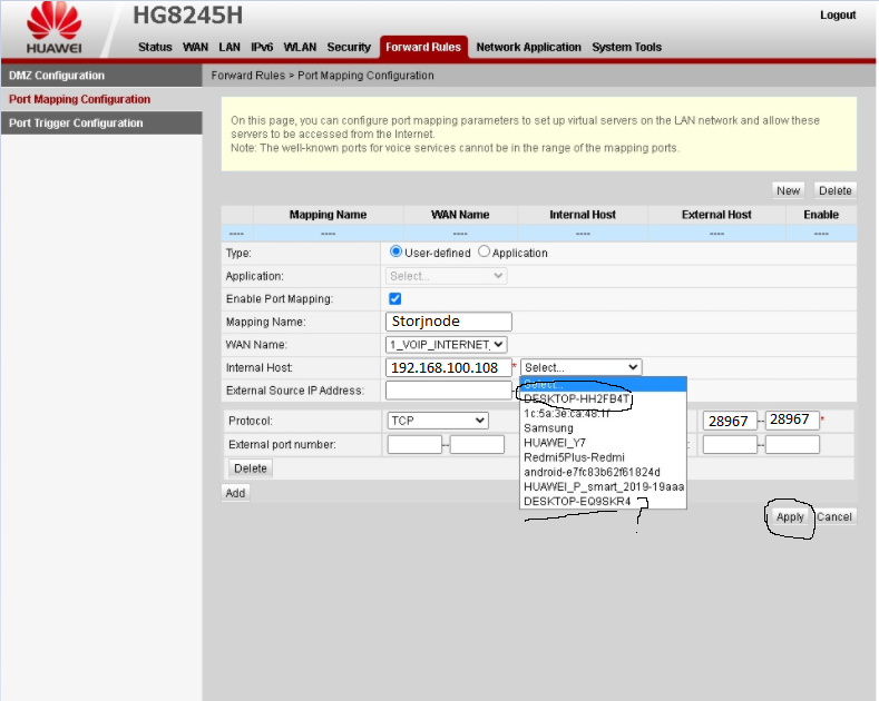

Second, on the PORT MAPPING CONFIGURATION tab. I have configured the router as you indicated it to me.
This should be all you need to have.
I gave you a picture of what to enter âŚ
28967-28967

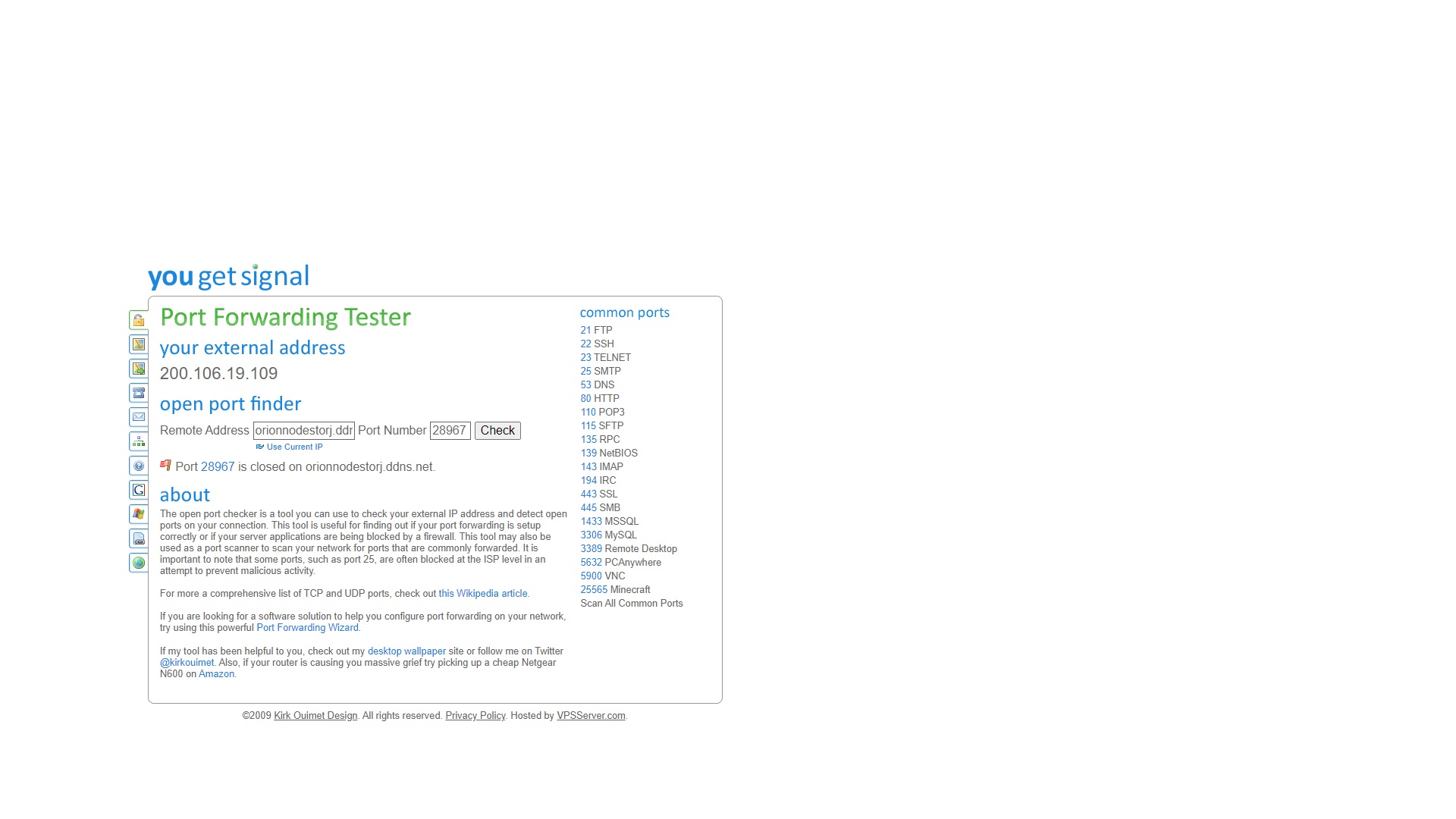

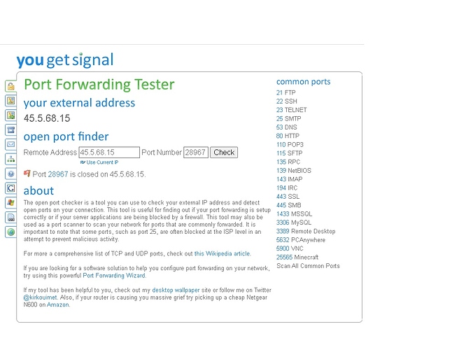

I have checked TCP port 28967 (at Open Port Check Tool - Test Port Forwarding on Your Router) obtaining the following:
** Port 28967 is closed on 45.5.68.15.
** Port 28967 is closed on orionnodestorj.ddns.net. -

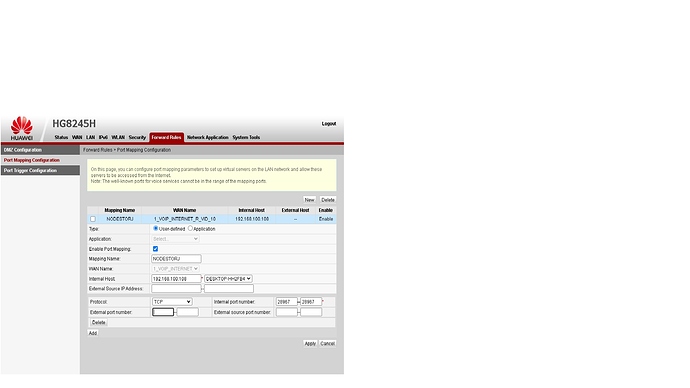

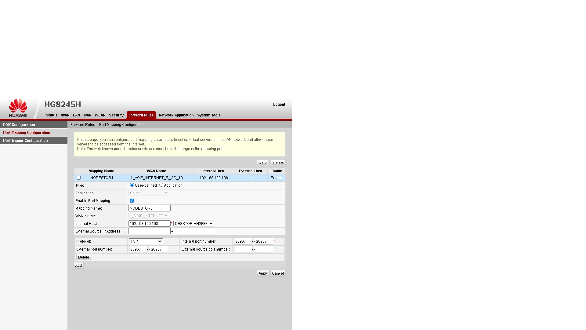

Have you tried to enter port number in âExternal source port numberâ? In all your pictures i see this field empty.
In the following image I have just modified what you said to me.
After I make the last change, apply the following rule in powershell in administrator mode:
Restart-Service storagenode
Restart my router saving the configuration.
Restart my PC.
Restart the node using: âRestart-Service storagenodeâ
