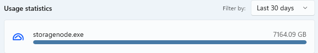

The last week I’ve consistently had 60% or less download success rate on my largest node. My two smaller nodes are still close to 100% success rate, and all 3 nodes run on 8TB SSDs (less than 10% utilization per drive). Is it possible the content in my large node is just being served up faster by alternate nodes?
All 3 nodes run on the same machine / same network connection so I find it odd only 1 is having download success issues.
Node Info: AtomicInternet Crypto Status
Error messages: wsasend: An existing connection was forcibly closed by the remote host.
