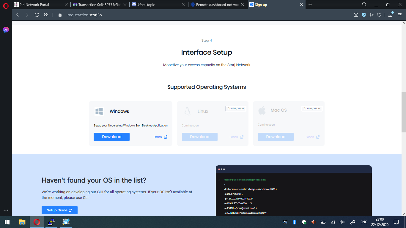

The guide for Linux: https://documentation.storj.io/setup/cli
his is for docker container im not interesting in his guide
official still shows coming soon
Ah, you want a “GUI” version?
You can get it now:

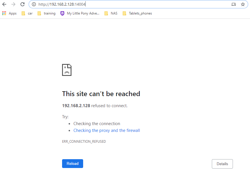

And currently I am expectinig to be able to open the dashboard on any browser on any of my PC in my local network. However, this does not happen.
I don’t see any related errors in the log file.

To me it seems that the linux itself can not see the opened port. I made this test:
[root@localhost ~]telnet 192.168.2.128 14004
Trying 192.168.2.128…
telnet: connect to address 192.168.2.128: Connection refused
[root@localhost ~]# telnet 127.0.0.1 14004
Trying 127.0.0.1…
Connected to 127.0.0.1.
Escape character is ‘^]’.
Connection closed by foreign host.
[root@localhost ~]#
As you can see the port is opened on the localhost but not on the IP. Can I somehow route it ? I tried modifing the hosts file to look like this but this did not help:

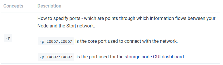

You need to change your docker run command as per fmoledina’s post above. The docker -p option syntax is:
-p <external OS port>:<internal container port>
The storagenode software inside the container uses ports 28967 and 14002 for connection to the network and dashboard respectively, unless you intentionally change it via the config.yaml file.

To be honest I just know this due to having been involved with the project/running nodes for a long time. I cannot point you to any official documentation regarding this configuration, but I can link a post from a Storj employee who describes it.
You can read more about how the -p option with docker run here:
It says so right in the documentation that you’ve linked.
I hope you understand the -p notation for Docker. The left side port is on the host and that will forward to the right side port which is in the container. Unless you’ve changed the storagenode config.yml it is highly likely the the right side of these port definitions should be left unchanged. You’re free to use whatever port you need to on the left side.
What is the output of docker ps -a | grep storjlabs? We’d be able to understand what ports are being exposed by the container and help you forward them appropriately from the host.
As a side note, instead of the above I’d suggest -p 127.0.0.1:14004:14002.
The 127.0.0.1 makes sure the dashboard cannot be accessed from the Internet.
And this should be -p 28968:28967, as outlined by @fmoledina.

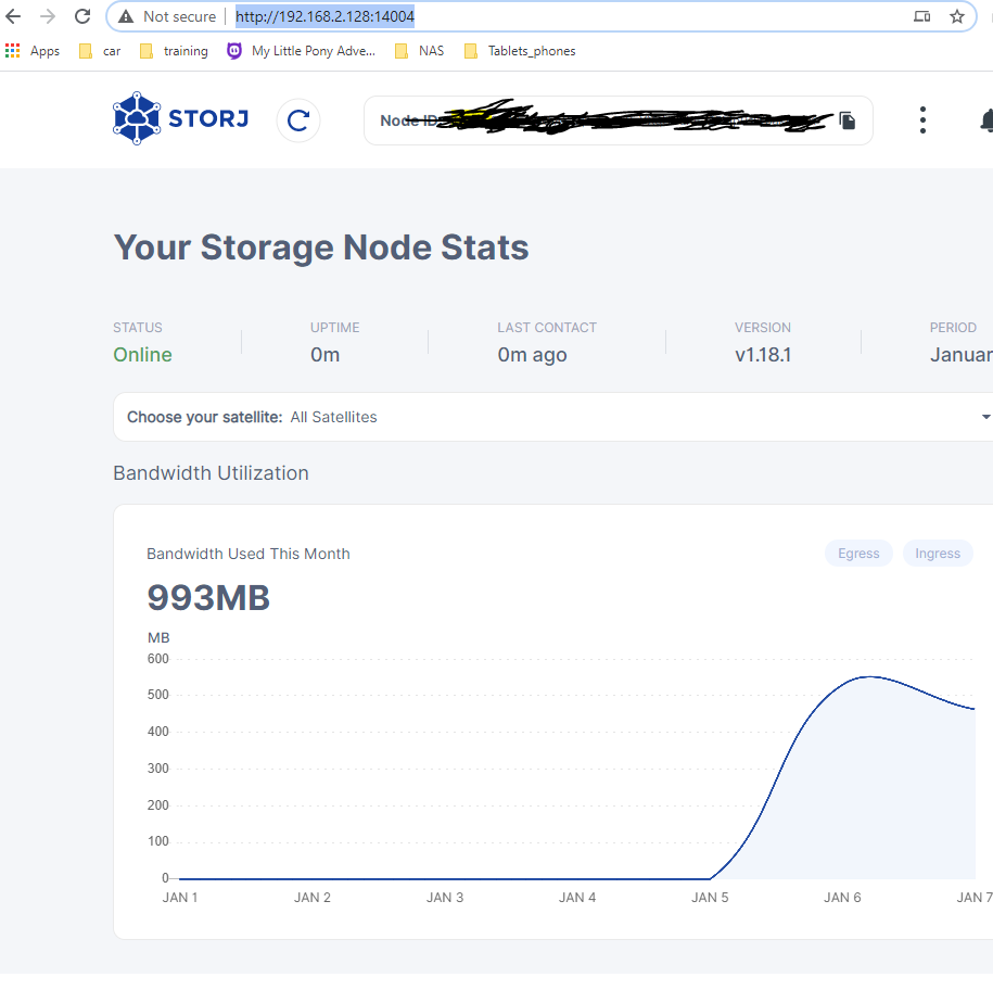

Great guys it worked:
After you explained it to me, I configured it and as you can see it works perfectly.
Thank you very much!
