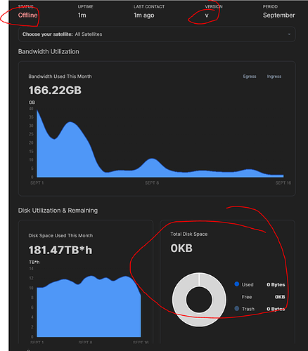

My node appears to be operating normally based on the logs I’m seeing in the console (shown below) it seems to be receiving and sending data…
storj                   | 2020-09-16T21:50:32.057Z      INFO    piecestore      upload started  {"Piece ID": "JXKRKWXGRA6NBP353WHIDLCHIRXUZ3ESTJKEWN62CPPCW7LI5NIQ", "Satellite ID": "12rfG3sh9NCWiX3ivPjq2HtdLmbqCrvHVEzJubnzFzosMuawymB", "Action": "PUT", "Available Space": 1995039876864}
storj                   | 2020-09-16T21:50:32.122Z      INFO    piecestore      uploaded        {"Piece ID": "JXKRKWXGRA6NBP353WHIDLCHIRXUZ3ESTJKEWN62CPPCW7LI5NIQ", "Satellite ID": "12rfG3sh9NCWiX3ivPjq2HtdLmbqCrvHVEzJubnzFzosMuawymB", "Action": "PUT"}
storj                   | 2020-09-16T21:50:45.414Z      INFO    piecestore      upload started  {"Piece ID": "RNL6CIX3HYVI2AUGHGGKGJJBLUEBMJUNBG2COZX5LZWAMHTA6SHA", "Satellite ID": "1wFTAgs9DP5RSnCqKV1eLf6N9wtk4EAtmN5DpSxcs8EjT69tGE", "Action": "PUT_REPAIR", "Available Space": 1995039875584}
storj                   | 2020-09-16T21:50:53.050Z      INFO    piecestore      upload started  {"Piece ID": "6DHJNI6LSLIDAEG7O7V2F7XUGRHJYEIGP6MJJTWV6XP64MMV5OEQ", "Satellite ID": "1wFTAgs9DP5RSnCqKV1eLf6N9wtk4EAtmN5DpSxcs8EjT69tGE", "Action": "PUT_REPAIR", "Available Space": 1995039875584}
storj                   | 2020-09-16T21:50:54.644Z      INFO    piecestore      upload started  {"Piece ID": "ZCWPT3HYBBQRQXEVZR7IVD5TIKO7M7NNLKXAIQKQPOIXJKNRHOIA", "Satellite ID": "12rfG3sh9NCWiX3ivPjq2HtdLmbqCrvHVEzJubnzFzosMuawymB", "Action": "PUT", "Available Space": 1995039875584}
but the dashboard indicates that the node is offline
you’ll also notice that the Node ID and other information is missing.

Hi All,
I just checked my Node and nearly had a heart attack when I saw this:
I logged into the node to double check and I get this:
I restarted the node before the second picture to see if that would fix the Dashboard in the browser but it didn’t!
Do I need to worry about this or will it correct itself?
Thanks
Clear your cache Ctrl F5
