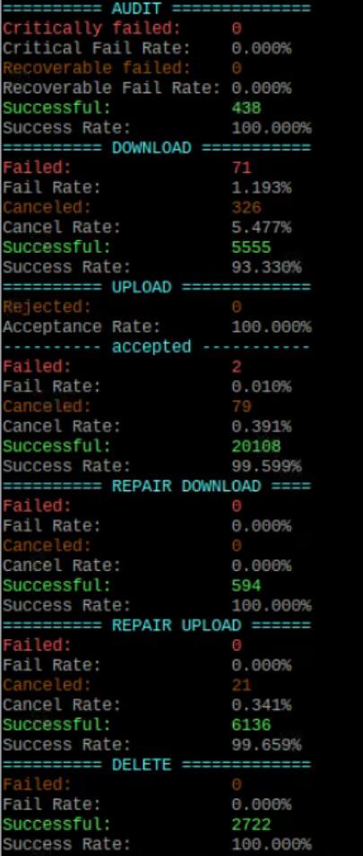

Raspi 4 8Gb running 64bit Raspbian and Storj 1.9.5 on an external USB 3.0 disk (WD MyBook):
