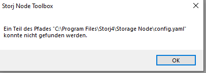

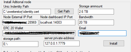

Hello, I’m trying to add another hard drive. Ports are released accordingly. I get every time the error message that a part of the path to Config. yaml was not found. However, the config is located in the new folder. Where’s my mistake?1
can you make screanshot how do you add this?
Attached is the screenshot. A new Storj folder is created under C:/Programs and this folder contains all necessary files including the config.1

in my config.yaml
total allocated bandwidth in bytes (deprecated)
storage.allocated-bandwidth: 0 B
I have this option enabled with 0.
Is this okay or should I change it? I have 100/100 bandwidth and no data transfer limit.
This in reference to the previous image showing a figure of 20TB.
I have already created 1 node on the PC with the tool and it is running. The folder with the config is obviously created as part of the installation. But I didn`t made the first one as Main node… How do I Change that?

Did that. Same message. There is a new node but it can`t find the config and therefore the Dashboard stays offline
can you go to service of this node, and make picture frome filepath
I don’t know what happened this time. Now the installation went without problems and the config seems to be found. However, there is still a problem that the dashboard displays offline. Rerouted externally 28969 to intern 28967 in the router. First node runs on the same computer on 28968 externally and internally 28967. . . Node 4 in the screenshot is the new node
is your indentity signed? windows firewall port opened?
and you cant run boath nodes on same port on pc
Thats it… My mistake. Thanks for your help!
