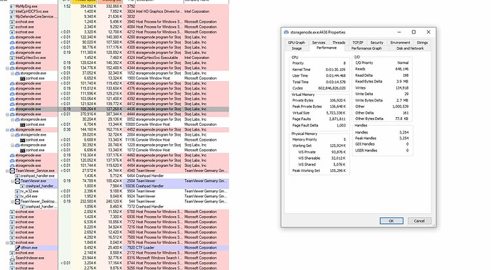

then we see other picture.
Process Name Total VM(MB) Used VM(MB) Remaining VM(MB)
storagenode 5446.96484375 31.63671875 5415.328125
Does someone have any problem with big RAM consumption?
Or node turn OFF without Error in log
I migrated to Hashstore but not activated memtbl.
interesting that on other server, where memtbl is active memory consumption is the same.
Which Windows operating system is it 10, 11, Server ?
I use windows 10 pro, on every server
Windows Server 2022 looking very much the same…
storagenode  7976,3046875 1115,87890625    6860,42578125
storagenode  8208,4296875 1062,70703125    7145,72265625
storagenode  6432,0390625   319,40625     6112,6328125

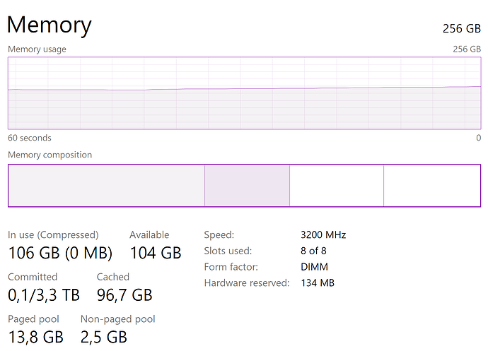

On my windows servers “automatically manage paging file size” is checked. So I did not run into memory problems because OS did the adjustment automatically.

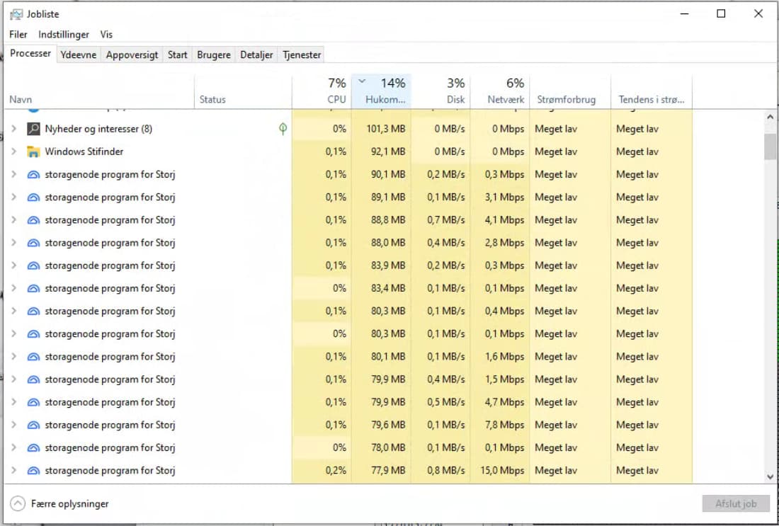

My nodes dont use much - but on this server they are also very new nodes.
my nodes show about same RAM consumption, but virtual memory is little bit other thing.
