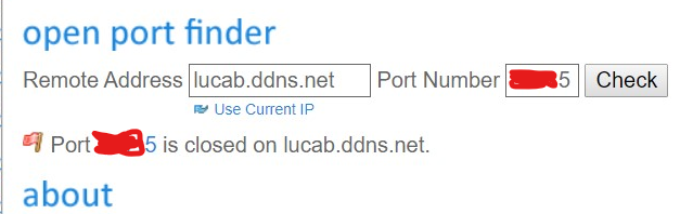

The custom port which is known on the network is closed at the moment.
You can create a support ticket on https://support.storj.io and provide a whole information, if you don’t want to share it on public.
It is open just when I start the docker SN, also if it is OFFLINE! Now my docker SN is stopped because it doesn’t work!!
