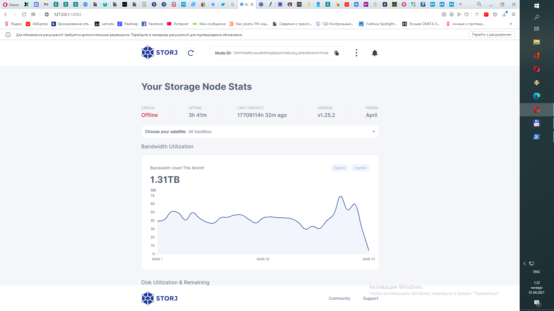

Hello. My node suddenly went offline. System - windows 10 pro. I checked the router, all settings are normal, restarting the router and computer did not help. The internet is stable. Access to the data disk without problems. It took 2 hours to do nothing. Before the node stopped working with the computer, nothing was done, it worked without shutdowns for more than a week. What could be the problem?
Show last 10 lines of the log.
storagenode.log - this is it?
Yes

Your node seems to be working. Where do you see your node as offline ? A screenshot will help.
Use Chrome, Edge or Firefox and not Opera.
in the opera, the node was almost a year, without any problems. launched in edge, same effect, does not work
firefox doesn’t work either. still have ideas?
Restart the node and then show us the log files.
